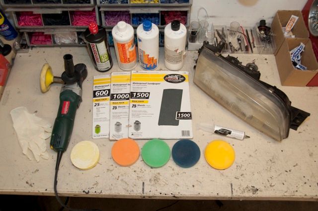

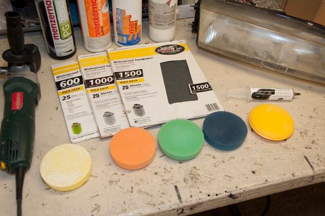

    Materials Used:
    Uber Microfiber Towels
    Gloves
    Metabo Rotary buffer
    4″ Uber Foam Pads
    -Yellow Compound Pad
    -Orange Medium Polish Pad
    -Green Polish Pad
    -Blue Final Polish Pad
    Optimum Opti Coat 2 Nano Coating
    Ultimate Menzerna Polish Kit
    -1 quart of Power Gloss
    -1 quart of Super Intensive Polish
    -1 quart of PO106FA
    -1 quart of PO85RD
    Sandpaper
    -600 grit
    -1000 grit
    -1500 grit
    Sanding Pad or Mechanical Sander

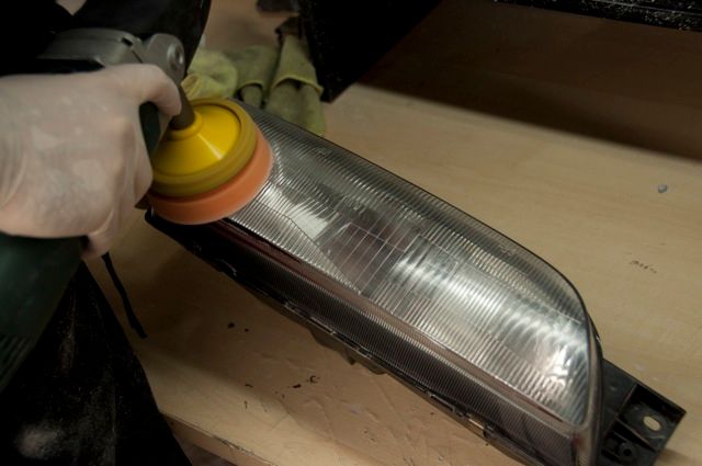

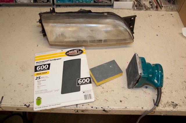

    You want to start off with the 600 grit sandpaper. Its strong enough to eventually get through the original coating to expose a fresh layer of the lens. Anything under 600 will also work, it will simply be tougher to remove all the scratches the paper itself leave behind. You can do all the sanding steps by hand, but its easier with an electric sander if you have access to one.

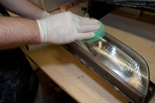

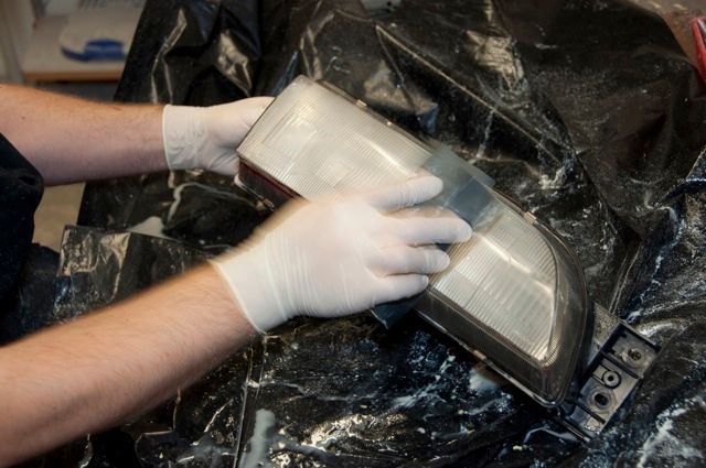

    Get it really wet, this will lubricate the paper and expedite the process. We use a garbage bag underneath. Just a note, this will get messy!
    Finish up my hand for smoother results

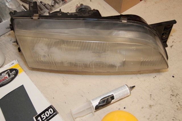

    So this is what you are left with after some work. You can see the original layer is completely gone and you have exposed a new fresh layer of the lens that will be suitable for the restoration.
    Repeat the same results with the 1000 and 1500 grit paper. You will notice a little bit of an improvement.

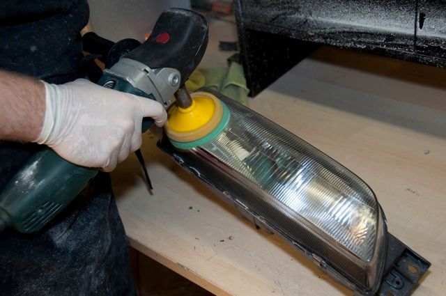

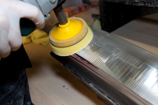

    Now onto the compounding and polishing. You want to use a high quality compound, we used the Menzerna Power Gloss. This is going to restore the luster in the lens. Apply a small bit to your pad and go over the lens with your hand to rub it in. Next place the pad on the backing plate of the rotary or orbital buffer and work on the lens until you see the desired result. Your main scratches should come out and there should be alot more clarity in the lens.
    Final result after the compounding

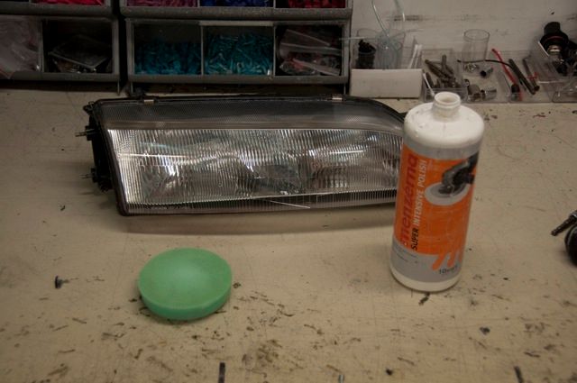

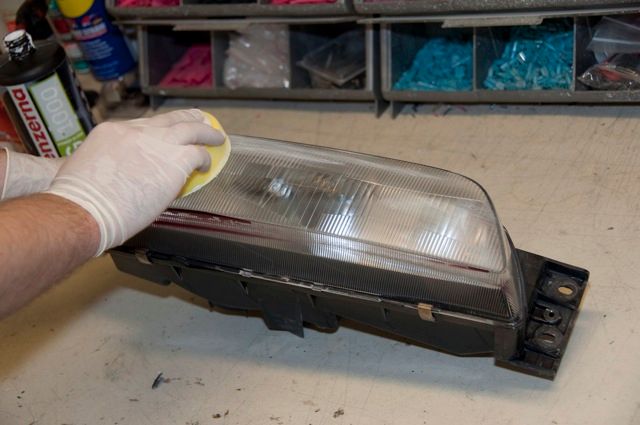

    Repeat with your yellow polishing pad
    Results after polishing pad
    Repeat with the green and the blue pads. You will want to use a true polish on these. We also used the Menzerna line which we feel gives the best results.

    The Opti Coat will come with a syringe filled with the coating and an applicator pad. Be sure to follow the directions that come with the product.
    1. Remove defects to your satisfaction
    2. Clean surface to remove all polishing oils, waxes, and silicone.
    3. Prime the applicator by makingan X across the pad. Only a few drops will be needed for eachsubsequent panel.
    4. Wipe Opti-Coat on a single panel at a time in a thin layer using several directions for even coverage.
    5. Inspect the panel with adequate lighting withing 5-10 minutes looking for any thick areas that have not flashed away to clear.
    6. Use applicator or paint safe microfiber to even out (no pressure)any spots where you see streaks.This step is key, as any spots not leveled will have to be abrasively repaired is allowed to cure. Panels will feel a bit tacky and will beself -leveling during cure time, so avoid any unnecessary touching,wiping, or contact to produce the best results.
    7. Repeat steps 1-6 for each panelwhere application is desired.
    NOTE: Take care to getcomplete coverage in your initial application as Opti Coat Can Not be layered.
    It will not look like anything has happened. In the light you may be able to see the streaks. Wait 5 minutes as directed and use a microfiber towel to wipe away anything left over.
