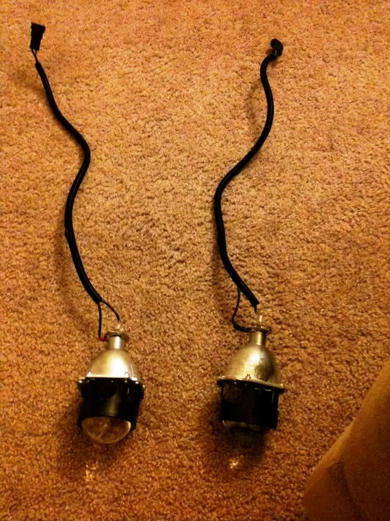

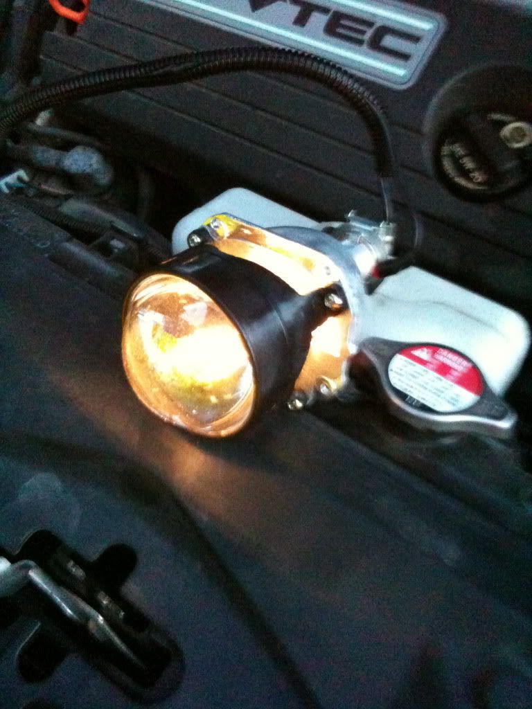

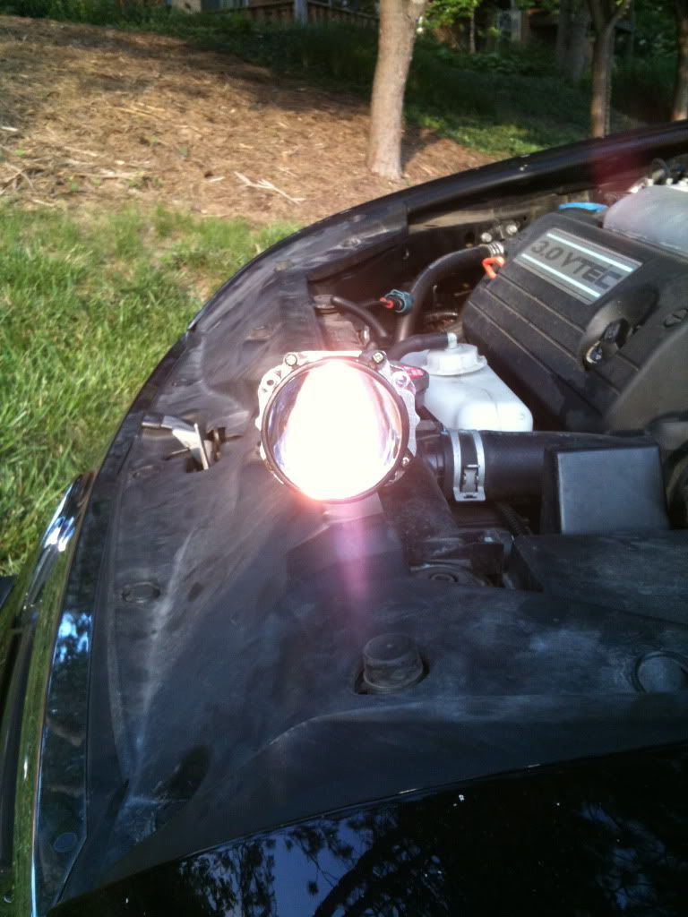

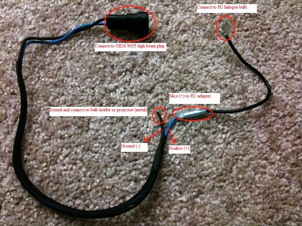

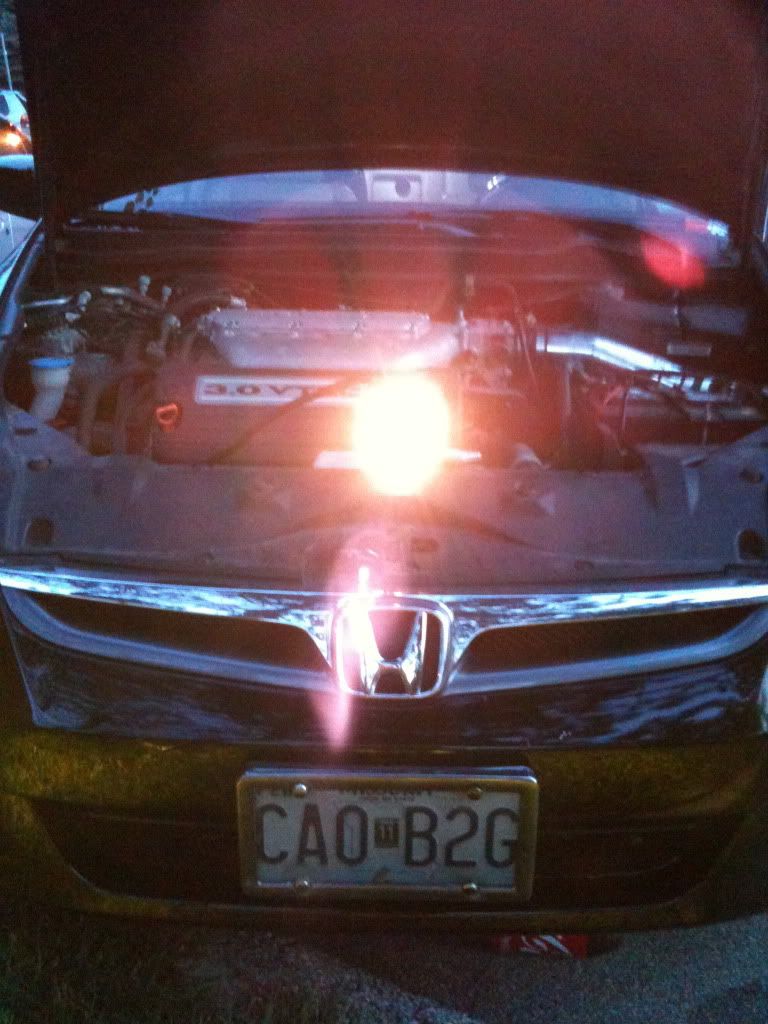

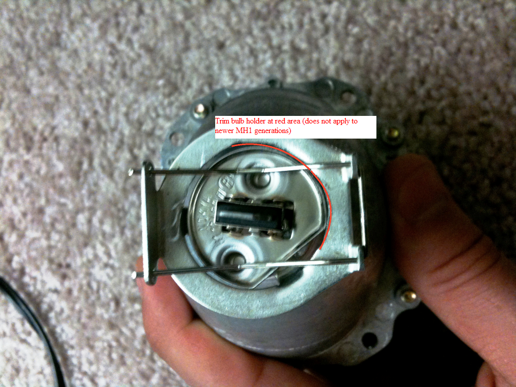

    Someone requested this, so I thought I would make the how to for everyone. This is using a Gen 1 MH1 to be a halogen DRL and high beam. I have now had this in my car for about 10 months using a Sylvania 55w H1 Halogen bulb with no issue!

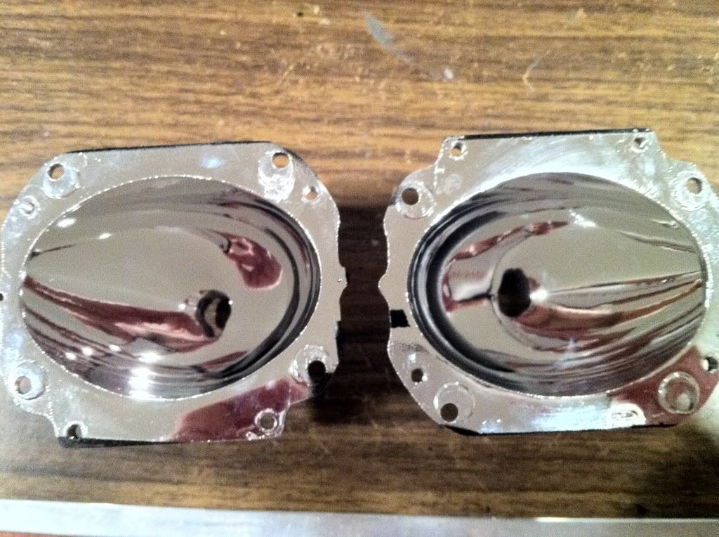

    UPDATE (5/13/11) - I removed the projectors from the retro after around 1 year of use and took pics. Bowls are unaffected.

        I updated the OP with a pic of the bowls after around 1 year of use (very last pic).

            Would it be possible to retain the low/high beam function and still use a halogen bulb?
            I mean, is the shield removal essential to prevent heat buildup?
              I think it was just to make the beam pattern more suitable for DRL use
                Yes, but I think it also uncovers the bowl as a side effect, and helps the heat escape better.
                  Where did you get the cable from? I'm trying to mod the mini h1 5.0 to h1 halogens.... got the bulbs in and can work a clamp up.. but other than straight soldering the one lead to the bulb base I'm not sure where to get the parts to do this.. Ideally I'd like to order this...
                    I got the adapter from advane auto parts then cutom mad the adapter from there.
