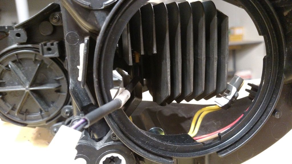

    It fits! After 2 days of off and on trimming...test fitting and some more trimming everything has been closed up! This is probably one of the closest fitting retrofits I have ever worked with (meaning...if it weren't for these I would have had mini H1's because of limited space) and aside from some dust on the projector lens everything turned out perfect. Now here is hoping these LED projectors last. It looks like I cut quite a bit off of the projectors but it looks worse than it really is...maybe 20% off? I was looking at pics of the Corolla projector and it looks comparable so here is hoping! I am quite pleased with the output but they are not very wide nor really bright but they are my favorite to date. My last set up was ES350 projectors with all the mods minus the curved shield and I like this set up so much more! I have all pics except output pics...forgot my camera on my drive.
          you definitely trimmed a good amount of the heat sink off. we're you able to take temp readings near the chip prior to cutting? would be interesting to know how much cooling is lost. if anything, if this is a passive cooling, you could make up the difference by flowing air over the remaining part of the heat sink.

                I would like to know too! but I do not have a way to measure. I looked at the corolla projector and figured it was about the same as what I have now. I do have provisions for a fan if needs be. I left the back mostly intact...it was the front that took a beating. Besides...it appears the high beams I have use the same LED...so if things go south before I decide I need a fan I have two replacement LEDs.
                Another thought too...I have to whole piece that the projector mounts to. It is cast aluminum but a bit thicker. They are directly attached to each other. Not sure how if any difference that would make.
                Edit...again...it looks like what my projector is mounted to is the same thickness as the heatsink on the Corolla version... Without any facts Ill say that the thermal transfer to the mount will make up for what has been cut off.
