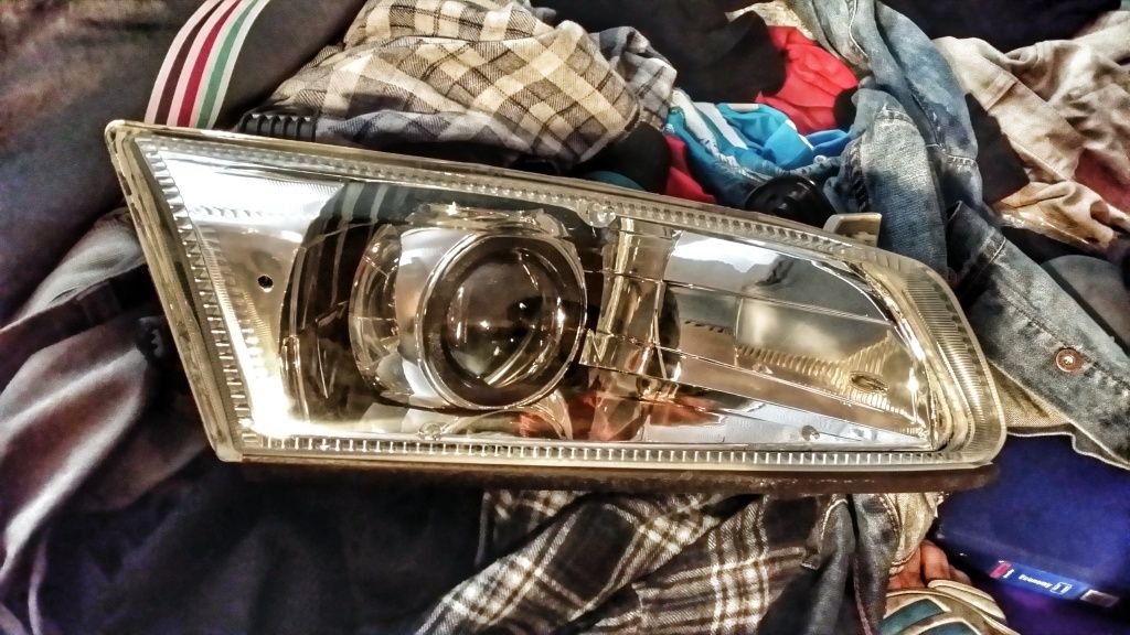

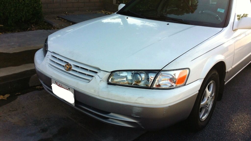

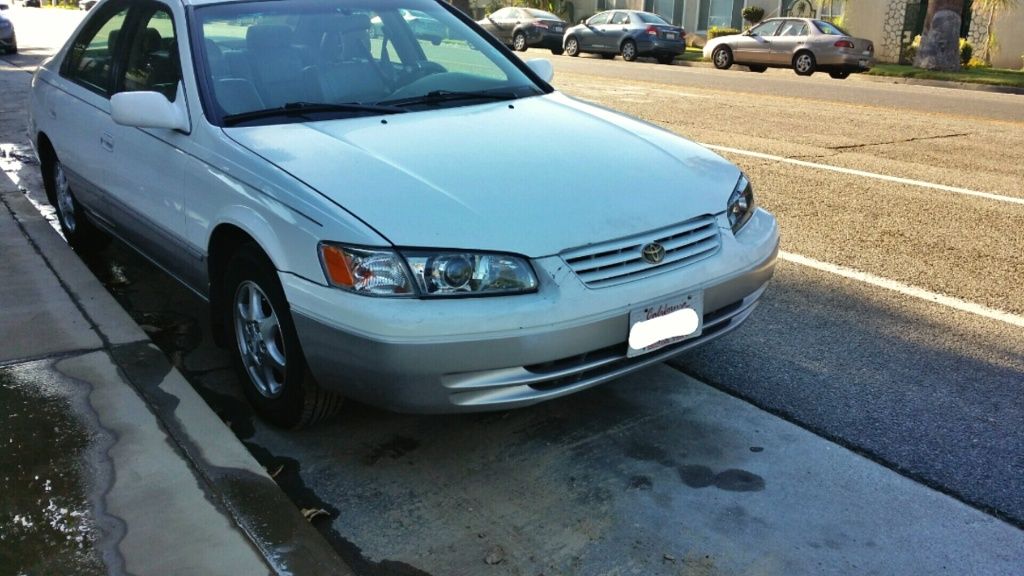

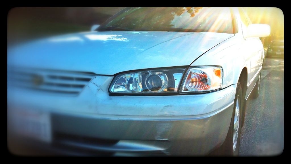

    I did a simple retrofit for one of my friends. Tried to keep it looking somewhat OEM. What do you guys think?
    1998 Toyota Camry XLE (4th Generation)
    Depo clear Lens Housings
    Morimoto Mini D2S 3.0 Projectors
    Iris Shrouds
    Osram CBI bulbs
    Morimoto 5five Ballasts
    1998 Honda Prelude Retrofit with TL's, E55 Shrouds, and TL-R Solenoid Kit
    1998 Toyota Camry Retrofit with Mini D2S 3.0, Iris Shrouds, and Depo Clear Lens Housings
    That actually looks really good! It's weird to see one eyeball projector in really long rectangular housings but this one came out well. Great work.
      Looks perfect!!! Simply perfect. Sometimes simple is best. Looks similar to the second retrofit I did on my old Corolla.
        Very, very nice and clean!

            Looks oem, has that old school Lexus look

              Oh yea, that's what it reminded me of! Especially with the bottom painted gold/bronze.
                Love it. Clean, classy, OEM look. Great work.

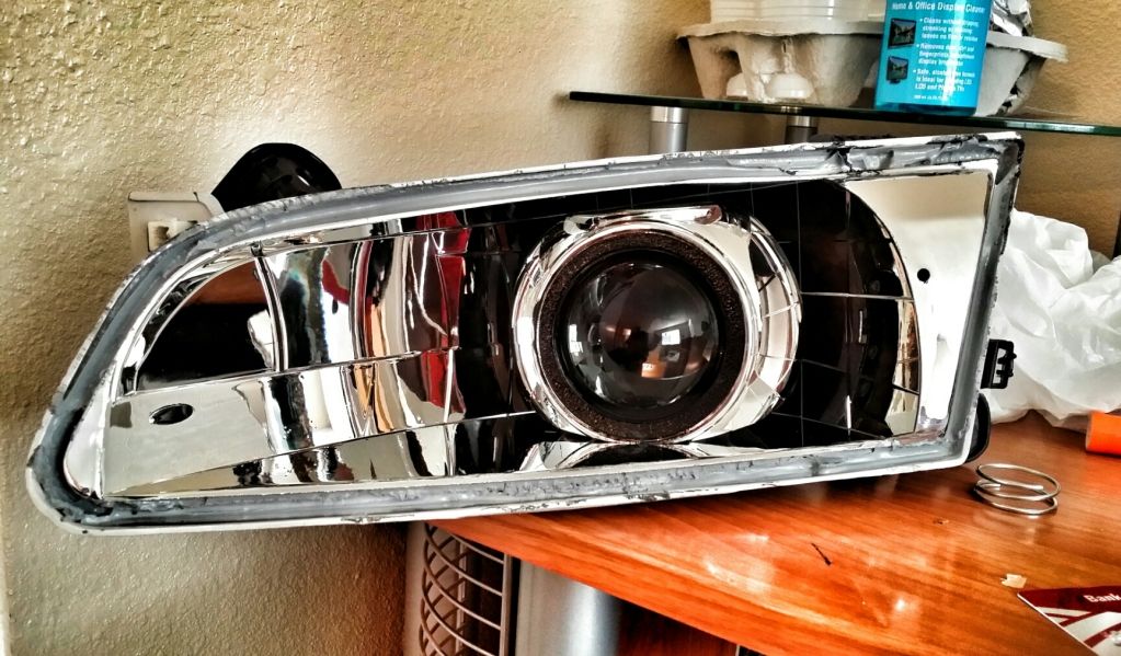

                    Yeah I will try to get some output shots if I can get my hands on the car again.The mini D2s 3.0's are pretty impressive. The high beam is really nice. What's cool is since the projector sits low and deep in the headlight, some foreground light gets blocked by the headlight housing. It acts like a foreground limiter and makes for better distance lighting lol. The mini d2s kit from TRS is a good price and the depo lights aren't too expensive on amazon. You should go for it!
                    Since this gen camry uses H4, installation was super easy. But I had to cut on a small hole at the bottom of the reflector to allow room for the solenoid's pigtail connector. That connector sits kind of sinked into the reflector, and I sealed the hole with aluminum tape.
