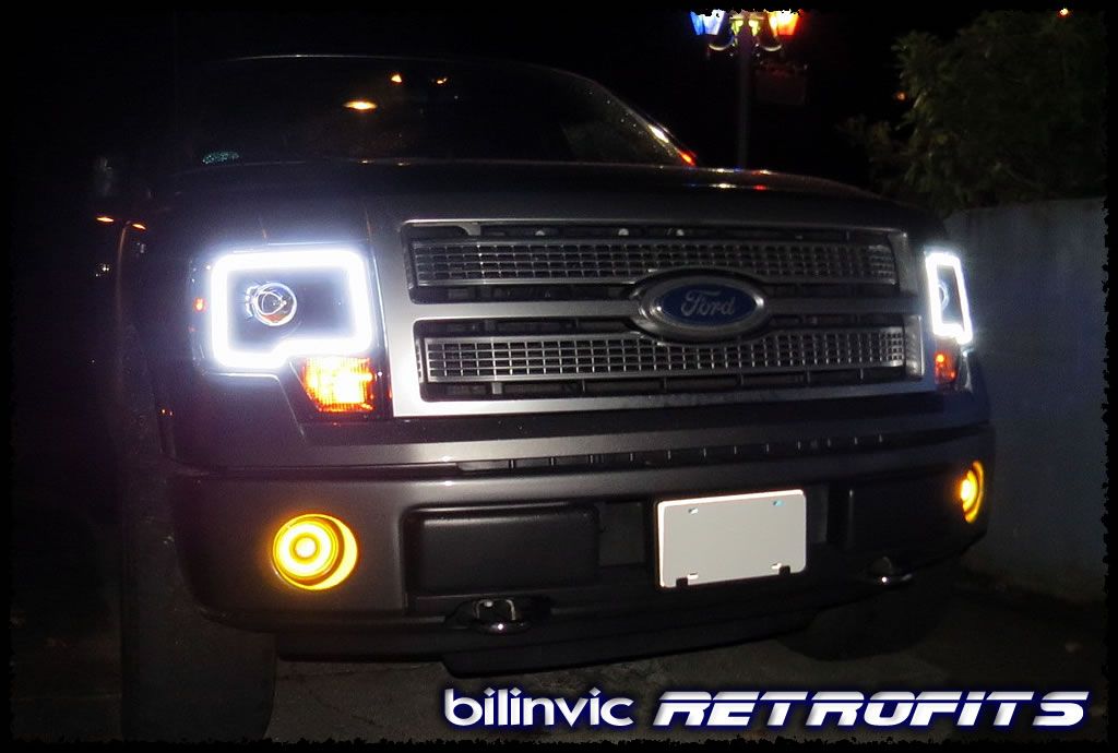

    Hey all, it's been a while since I've posted here...so I thought I would post some pics of another pair of headlights that I retrofitted for my own F150. I will be the first to admit, there have a bit more "bling" than the last pair...some folks will like 'em, some won't - I understand.
    Here's the specs:
    Headlights
    OEM Lexus LS460 Bi-Xenon projectors
    Osram CBI 5k HID Bulbs
    Morimoto 5Five Ballasts
    Shrouds painted OEM Sterling Grey Metallic (SGM)
    Reflector Bucket painted Flat Black
    F150 Logos painted OEM SGM/Gloss Black
    Tinted Turn Signal Lens; Dark
    Tinted Amber Reflectors
    Oracle LED Rectangular Halos; White (6k)
    Fog Lights
    9w LED Projectors
    OEM Reflector Buckets painted OEM SGM
    xbALED Amber Angel Eyes
    *drool*

      Interesting, so Oracle makes a specific set of "halos" just for that shape!
      How are the fog's output?

          Yes, Oracle makes these specifically for the F150. They are extremely bright. Tonite's the first night I have been driving around with them and let me tell you one thing...these rectangular rings with the amber circles turn almost every head.
          The fog's output is decent, where I found they are most effective is the light that is projected about the headlight's cut-off which helps illuminate signs. The nice thing about the fogs is that the projector style matches the heads.

                  Thanxs guys. I also purchased the same rectangular LED lights in amber....It was a toss up as to which set to use.
                    Interesting. I didn't realize it was a set meant for the F150. I thought it was a rope setup that you conformed to the housing.

                      Anymore info on the LED fogs? Link to product and output shots?
                        x2... link to the fogs.... and you should take an output pic of them!
                          The LED projector is the Well-Done Lighting 1L09, or the WD-1L09
                          http://www.well-done.net.cn/product_show.php?id=190
                          In Bulk:
                          http://well-done.en.made-in-china.co...-WD-1L09-.html
                          http://www.alibaba.com/product-gs/52..._fog_lamp.html
