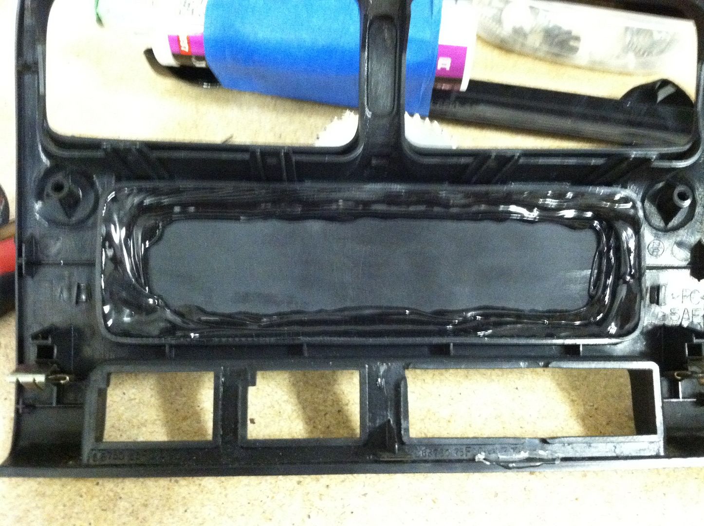

    So for christmas my girlfriend got me some gauges for my car...she basically gave me another project haha. So I could just go and glue them on top my dash but what fun would that be? I will be flush mounting the gauges in my center console where my hvac used to go. The hvac will be moved below the radio. I will also be doing a couple other little tricks with the boost controller.

          OP what are you using as a filler? Urethane?

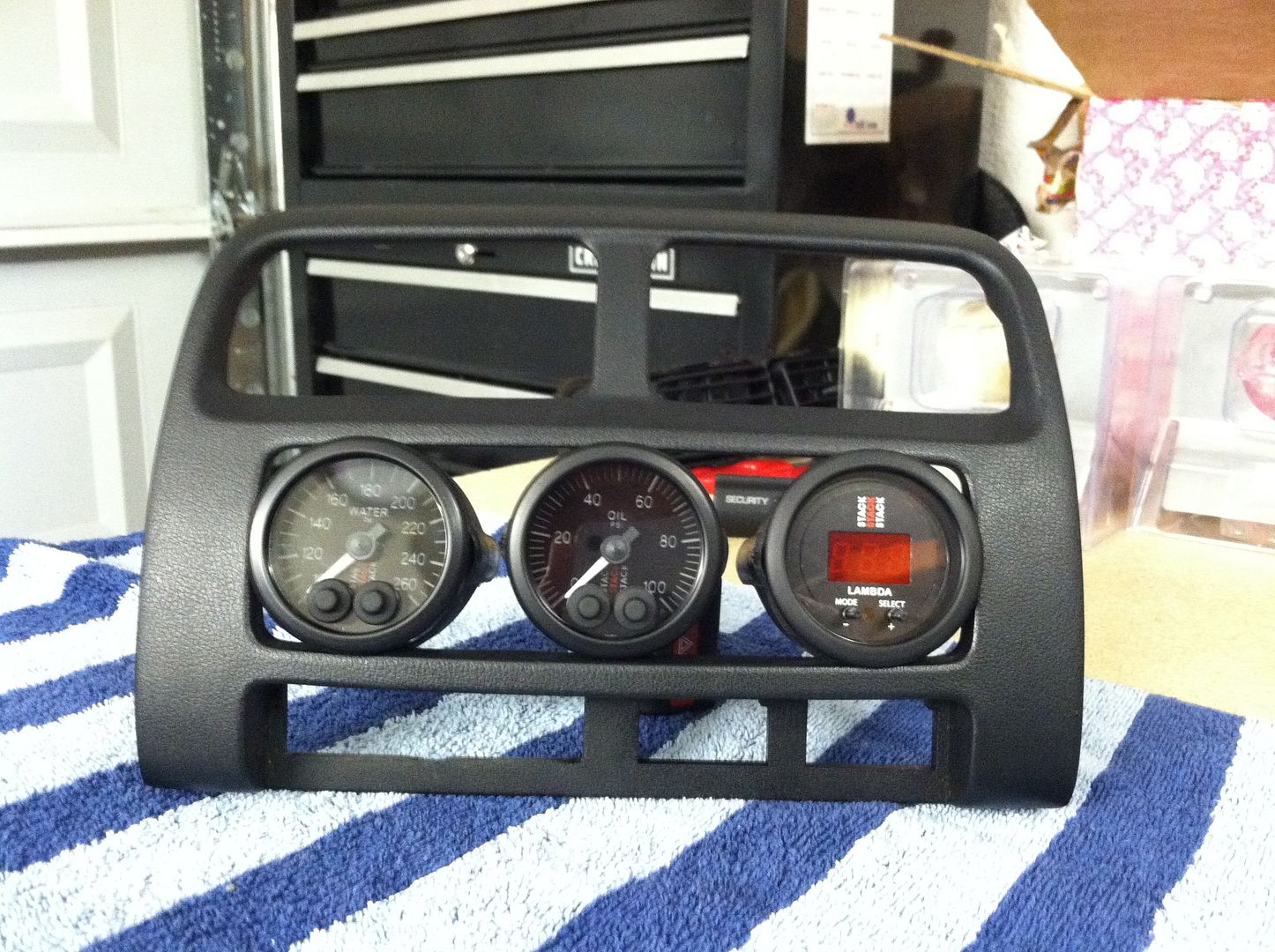

            I have used other gauges in the past (aem, greddy, hks) and they are too slow and not as responsive as stack. Stack also has programmable outputs for fans, lights, pumps etc at specific points you set; you can also set colors for specific ranges and it has peak recal, plus there quality is amazing. Full glass lens and the wire looms you would think we're from a BMW.

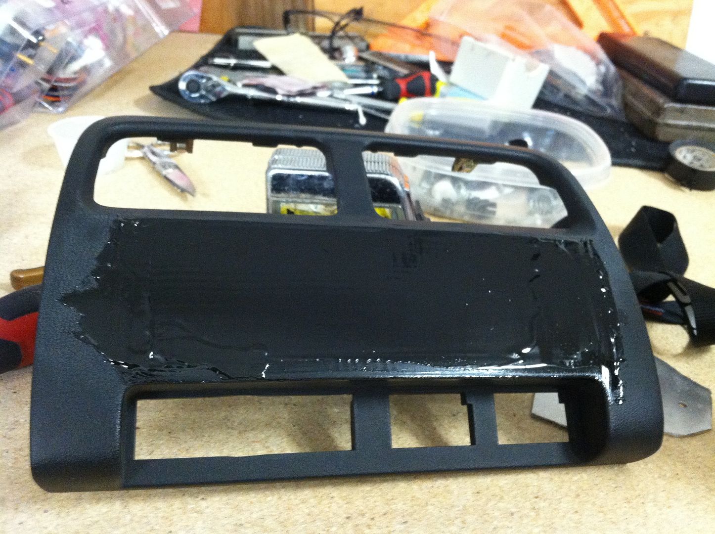

            Im using 3m structural adhesive, it's expensive but worth it. You can get different setting times and it turns rock hard after about 30min.

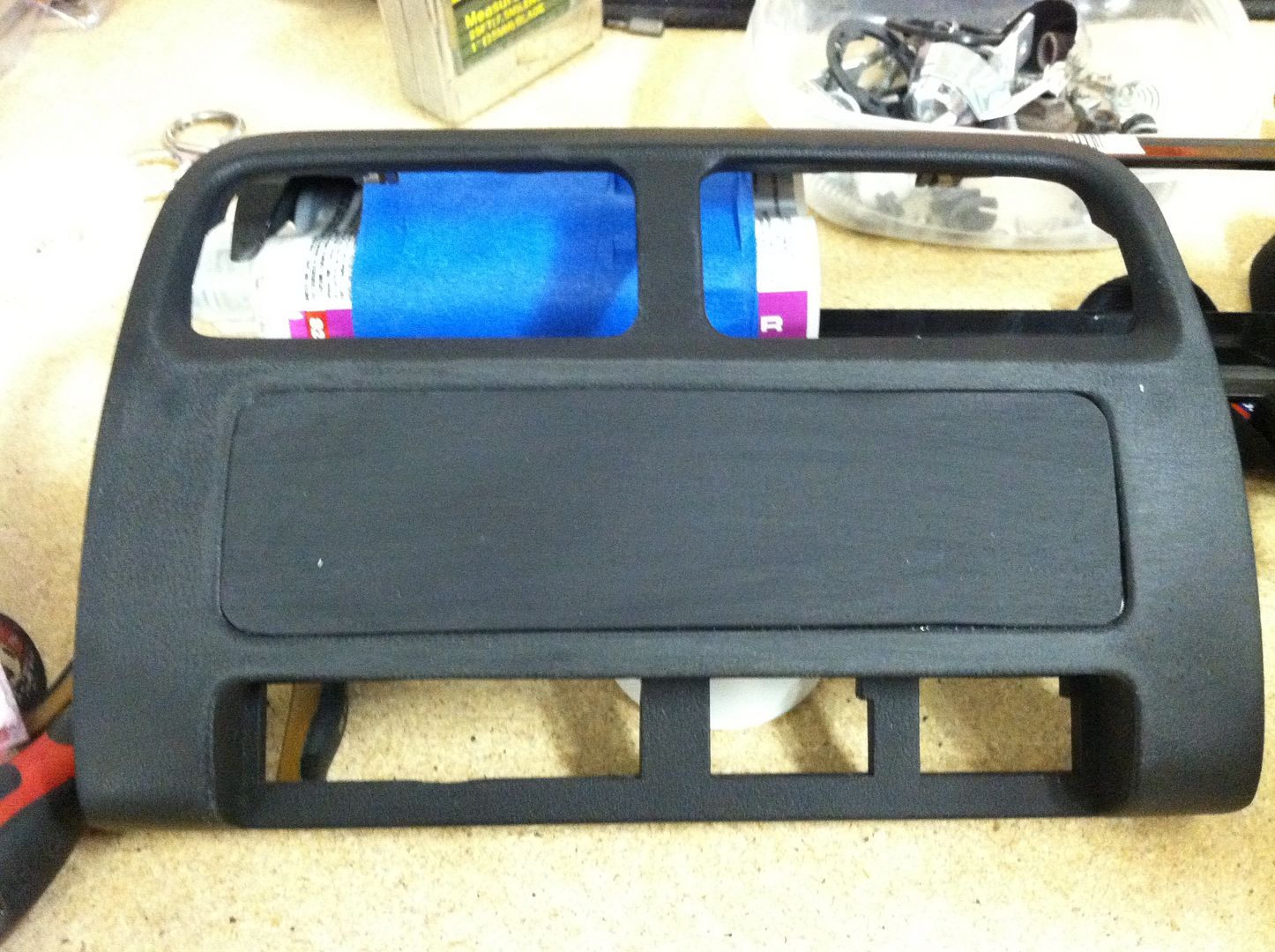

                  Any who here it is almost done, just gotta finish sanding and paint then wire it all up.
                    Looks good bud. Can you link me to that adhesive you used.
