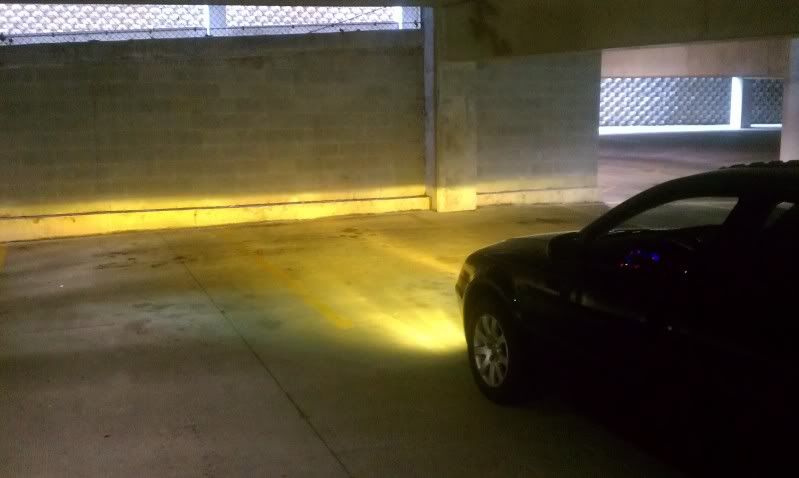

    Before and after output shots. Unfortunately right after i put everything back together, a lot of my adjustment screws broke. I even had to redo my driver side housing because it was aimed too low with no way to adjust it and i needed to at least get back and forth to class at night. So new housings are needed to get perfect aim but here they are.
    Here is a shot of my fogs for shits and giggles, they are projectors from factory. DDM tuning 3k, yellow laminx film.
