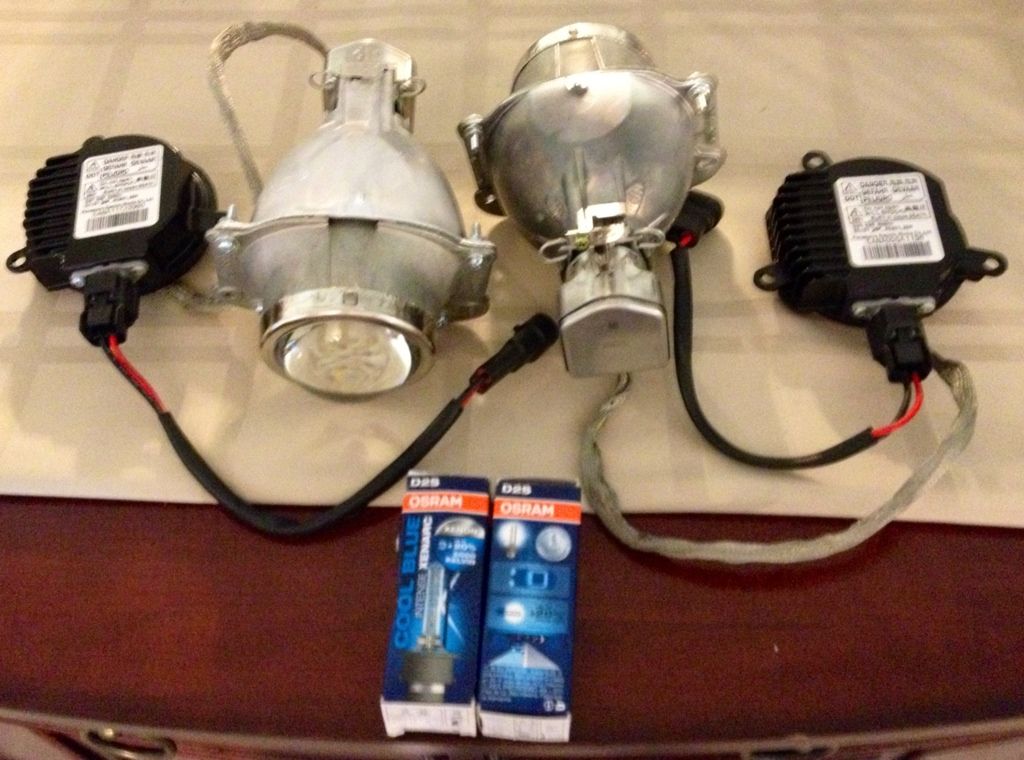

    I will be doing an OEM Acura TSX low-beam projector retrofit on my 2007 Honda Accord EX-L V6 Coupe (Graphite Pearl Gray) w/ 23k miles on her The projectors came out of OEM TSX housings, removed and sold to me by argo.

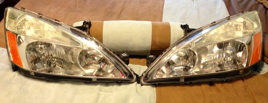

    I was fortunate enough to find a near-perfect pair of OEM Accord headlamps from Keith, over on the Accord forums, for a killer deal! These are very rare (& expensive) to find. The headlamps, including the non-functional orange reflectors, will be blacked out except for the chrome bezels around the high beam and turn signal. I have chosen to go with the E55-R Mercedes Benz shrouds this time, as I think they will compliment the headlamp nicely. The shrouds will remain their original chrome. As I did in my FX-R retro, and in order to better hide the projectors out of sight, the projector bodies will be painted black.

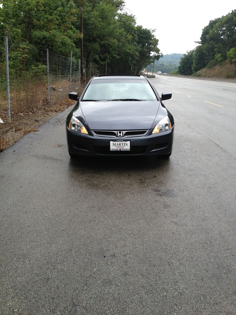

    The victim:
    The setup (thus far):
    OEM 2003-2007 Honda Accord Headlamps
    OEM Acura TSX Projectors w/ OEM Clear Lenses, OEM Osram D2S Cool Blue Intense (CBI) 5,000K bulbs, OEM Matsushita (Gen V) Ballasts

      Forgot to add, I have spaced 1 projector using haknslash's 2 washer spacing mod on the nipples (yes, I said nipples) and 1 projector left stock. I'm going to test later on which one I like better, or even yet, if these particular TSX's respond well to the mod. I know others have had to space on top and not bottom, 3 on bottom & none on top, etc. b/c each projector is definitely unique haha So I'm going to play around with them to see where I can get the best blue/purple cutoff along with keeping the beam sharp. I'm am dying with enthusiasm and curiosity to see how well the CBI's do in the TSX w/ clear lenses!

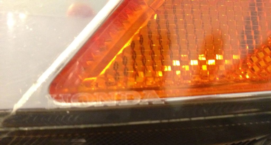

                            Should I leave the orange reflector, or black it out? I'm torn...
