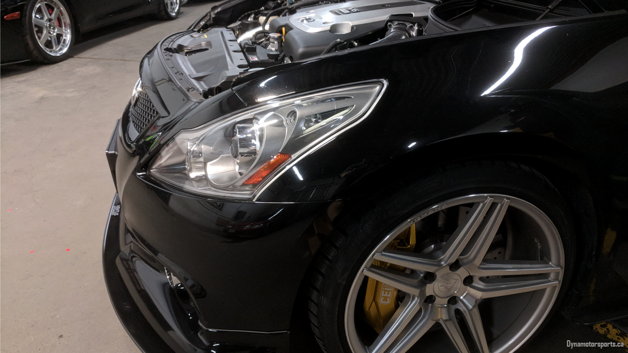

    So I spent the weekend doing a retrofit on a car that I am supposed to drive in winter...heh. Anyway, I was actually able to live with the factory projectors with a premium bulb (Philips Extreme Ultinons) when it was NA with bolt-ons for a few months. After I turbo'd the car recently, I did a few rips at night with the newly found power and it felt somewhat like I was about to drive off a cliff...
    Power + Acceleration + Speed definitely calls for better lighting...obviously...lol
    Lighting specs:
    2011 G37XS Headlight
    Morimoto MLED Projectors (Flipped-Chip)
    XSB LED Strip
    Other Lights:
    Morimoto ModPod LED Switchbacks
    Morimoto LED Fogs
    The retrofitting process was pretty straight forward... The factory bracket needed a little trimming, and just had enough meat on the projector to bolt it down with larger washers. It holds it just good enough, but I still ended up putting small dabs of JB Weld on the hardware just to be safe.
    I'll get better beam pattern pics once I drive the car again... The wall shot is at an angle, thus hotspot looks different in case anyone is wondering.

          Can you talk more about how you mounted it to the stock bracket? Did you just fab up some plates or was it bolt in? I also have a G and have been contemplating going LED.
            I too would love some more detailed info as to how you did it. Looks great.

                No custom brackets were made, so the M-LED projectors were bolted onto the factory brackets. The M-LED projector backing plate was just big enough for larger washers, and the bolt holes you see on the picture (3 screws) are factory screws. Additional washers were added behind the projector just for spacing.
                Minor trimming on both the factory bracket as well as the M-LED projector was needed to fit. It's not complicated, so any retrofitter will know what to do the moment you have the factory bracket on one hand, and the M-LED projector on the other

                  So it looks like you essentially made clamps holding the projector in place around the edges? Very interesting
                    Yup, the washers are squeezing the projector together, and there are 3 points holding them so it doesn't move anywhere
