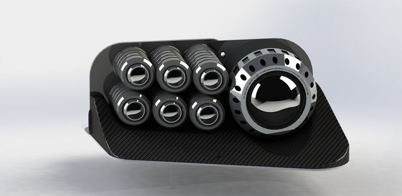

    I've been documenting my C5 non pop up headlight retrofit in a video build.
    Check out part 1!
    Part 2 to come soon... Here are a few renders from my CAD model:
    Enjoy!

    Looks awesome, looking forward to final product
      Very cool! Although with all that work, i'd probably use a better projector and reuse the shrouds.

        Thanks guys!
        Yeah I'm going to test the projectors out, and if they're not up to par with my expectations I'll swap them out for the latest Mini H1 generation.

          I'd recommend Mini D2S 3.0 or 4.0 instead of the Mini-H1.
            +1
            It doesn't look like the Mini H1 fits in without some margin there; the slightly larger D2S 4.0 should give you a good boost in visibility and allow the use of OE D2S bulbs.

              You mentioned using eagle eye leds for the corners but I don't recall you saying if it was for a DRL effect or switchback function to serve as turn signal to? Please don't use those cheap Chinese eagle eye leds. If those are going to be aluminum pods go with quality Luxeon Rebel 1-up led stars in each. Maybe 3 white and 3 amber.

                    To answer a few more questions... the "eagle eye" LEDs are in fact the Chinese ones. Obviously I'm not using them for illuminating anything, it's more just accent lighting than anything else. I have switchback LEDs in my dedicated turn signal housing and I opted not to tap into those and have even more turn signals. I didn't want to over do it. Sometimes less is more.
                    I'm currently working on the next video. To be completely candid, the whole thing is done at this point and they look pretty slick. I'm going to live with the H1 projectors for now, but I have a tendancy to not leave things alone.... so a D2S upgrade may be something to look into if I tear these down again

                              Sweet. That generic projector doesn't look half bad. Great custom build
