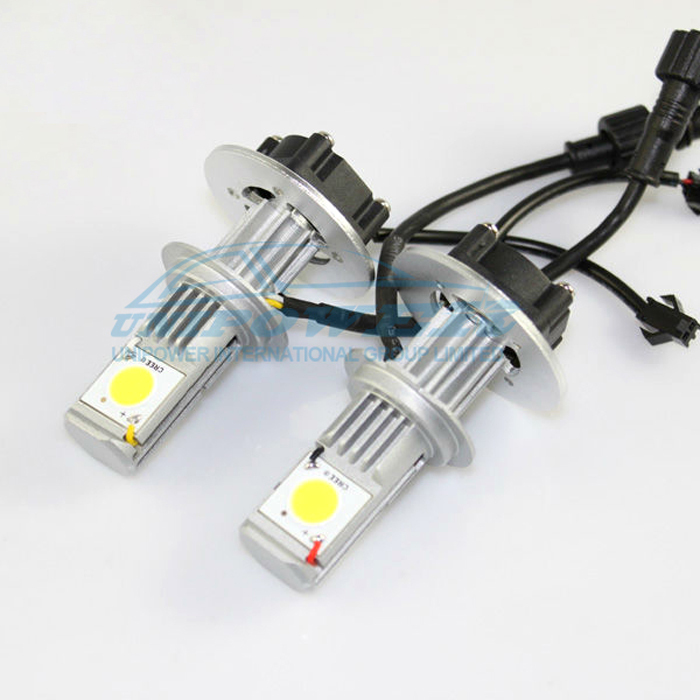

    i wonder if someone put those LED "HID" bulbs in a projector headlight?
    like this:
    or this
    they come with ballasts, so i think thats why they are always offered as "HID"
    Im interested in some output shots.

      LED in hid/halogen projectors does not give a good output.

          I wouldn't worry much about the glare above the cutoff as it's pretty insignificant but I would worry about the excessive foreground.

              Whatever light right under the cutoff (the most usable light) will be dwarfed by the overpowering foreground. In essence, you'll be left with short distance visibility.

                you got it exactly right. led bulbs have a consistent problem where they put all the light directly in front of the car, and the light doesn't reach as far down the road compared to it's hid or halogen counter parts.
                but because all the light is directly in front of the car, it appears brighter to un-informed persons.
                  tl;dr- its crap. stick to a HID retrofit

                          yes they would make great DRL, however you could a similar preforming DRL for far less $$$$

                            I tried a 9005/HB3 LED for high beam and the output was these:
                            Where it should be these (Osram Halogen NBP):
                            Looking at the headlights, it looks bright, but sit inside the car and it lights up all around; high, low, left and right except straight ahead.
                            The sample is not projector based but the main issue is the positioning of the light source.
                            Whether it's used in a projector or reflector system, if the positioning is off, the output is pretty much a fail.
