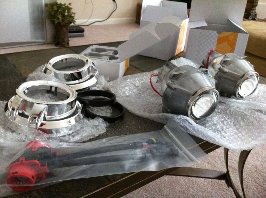

    Getting ready to do my first retrofit. I've been into Hids for about 2 years now. my first car had green hids and didn't even have a relay harness. My newest car is a 2006 impala has DDM relay harnesses and 35watt 6k in the lows and 55w 6k in the fogs. The low beams are aimed low and the fogs are already projectors (came standard with the car from the factory). The 06 impala has separate hi/low beams, low beam bulb is h11. I just purchased the PNP bi-xenon upgrade with Apollo shields and fx-r and waiting on oem headlights to arrive. Do I have everything I need for the retrofit (not including tools) just as far as wiring goes?

    Do your existing HIDs have a relay harness? Either way, you should be set for wiring.

      Yes they do. Is it recommended I upgrade the one for the low beam to the ones from TRS ?

        TRS' wiring harness is as close to OEM as you can get from a PNP harness. If you are going to take the time to retrofit, throw out everything DDM and start with a solid base. My .02.
        Also, post pics of current headlight/foglight setup.
          I like those shrouds! Looks like you are headed in the right direction to better lighting than you've had. Can't wait to see progress!
            yes it is it gives the ballasts a much better power sorce and it takes the start up stress off of your cars OE wireing

              i don't agree with this. americanmade, would it be possible to post pics of your current harness?
              normally, most of these harnesses are nearly identical. i don't feel there is a reason to replace the harness unless you are having a issue with it, or there is some part of it that inferior to other harnesses. so far, i haven't seen much info for/against any specific brands harnesses..
              change for the sake of change is not change, it's just waste...

                If I don't have to throw out my harness then I won't.

                    Yup, you definitely need some projectors badly
                      holy glare O.O man can you see ghosts with those things
                      anyways its awsome youve found the light known as HID planet your retro is going to look pretty cool in them lights im wondering how this retros going to turn out
                      oh and BTW you got an easy selinoid trigger for your BI-XENON high beam just hook em into the high beam wires and done deal you can even keep the OE H9 halogen high beam (god love quad halogen setups on new cars :3)

                        would I need the high beam splitters to do this ?

                          no if im correct with these your car has caps on the back of the light that cover the bulbs if it does you can use qwick splices to tap into the high beam ive done that before on a few cars (if your lights dont have the caps just use shrink rap to seal the connections)
                          i just cheked on if your lights got the caps and they do so you should be all good (youll need to mod your low beam cap anyways yo make it go back further to cover the back of your projector (ive used PVC piping and epoxy to take care of this issue and also a PVC piping end cap you could use other things but i find this works just fine you can run your wires out through a hole in the back and a gromit and seal it all up with some rubberised epoxy then that cap is redy to role
                          the only one you need to worry about is your D2S connector so theres no issue just put your amp connectors through the hole you drilled and through the gromit (make sure the gromit has a tight seal around the adapters wire and then hook it all up and your good to go)
                          if you can get a cuple of ballasts you can toss those pnps into your fogs maybe (its the same bulb for your lows as your fogs)

                            You can splice into the factory high beam wires to power the bi-xenon solenoid to activate the highbeam on the projector.
                            Also check to see if your low beam stays while turn on the high beams..
                            If not you will need to backfeed power to the low beams so they stay on aswell when you turn on high beams

                              on the impalas that this owner has all 4 lights are on for high beam
                              all new chevy vehicles as of 06 with a 4 lamp system do it and im my eyes it makes retrofitting a nice bit easear
