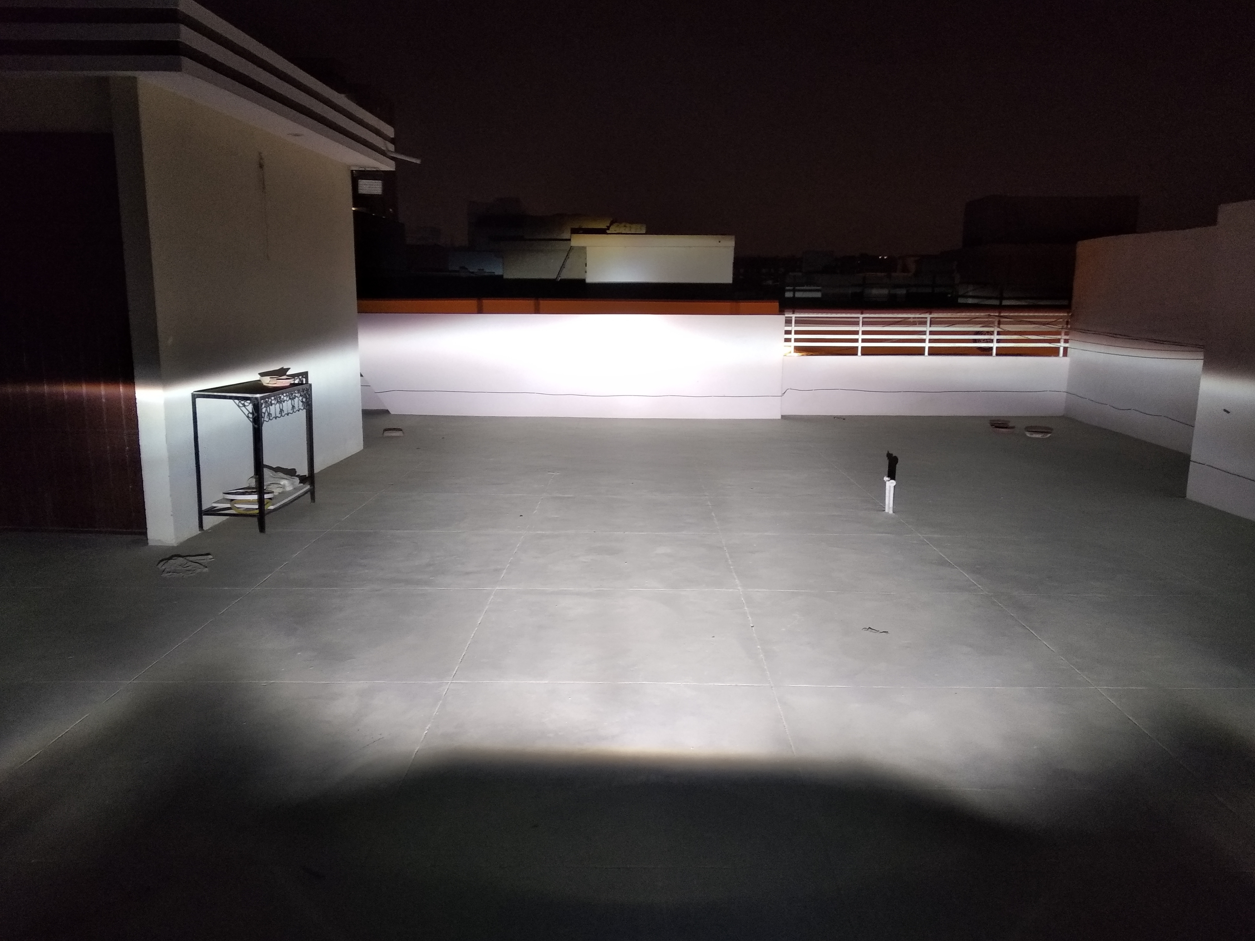

    Hi, need your opinions on following projectors output. second one is mormoto FXR3, first one is OEM koito.
    ​​​​​​​Which one is actually better,in terms of width, beam pattern,light output and cutoff. 2nd one seems brighter but is because of bulbs or projectors? these are the only pics i can manage

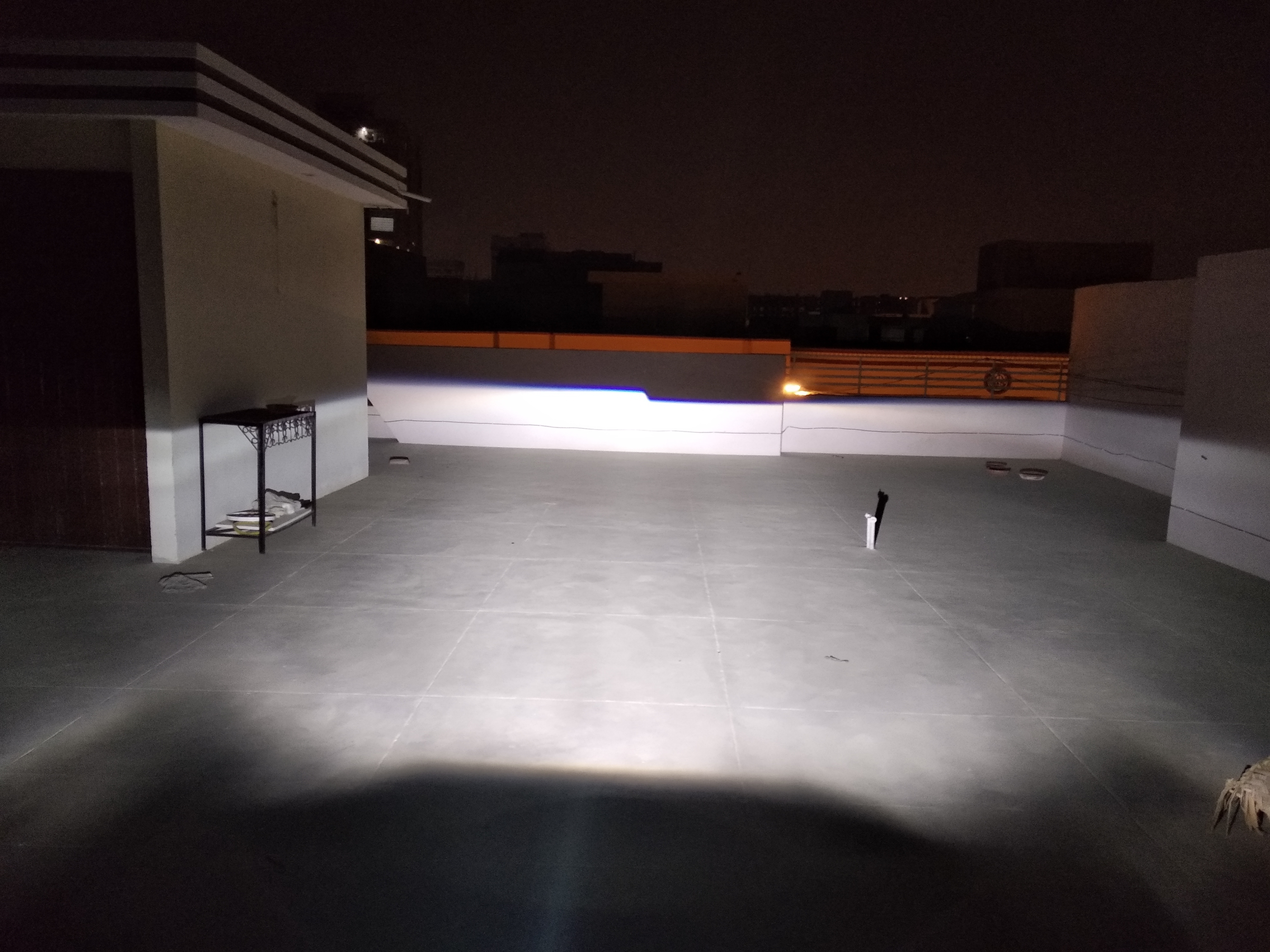

    Second one

    I don't remember the FX-R having a soft cut-off. Did you swap the pictures? The 2nd one which has the sharper cut-off and bright band at the cut-off looks more like the FX-R.
    Also, you can't tell width from that narrow area.

      my bad, you are right., second ones are FXR. Can you comment which among them is better generally if not from the pictures?
        Well, if you have both of them, just pick the one you like more?
          To expand on gold94corolla, if you can, light both projectors one above the other to get a direct comparison. Just make sure you don't cross beams to not have one complimenting the other. A good way to avoid that is to place one upside down.
