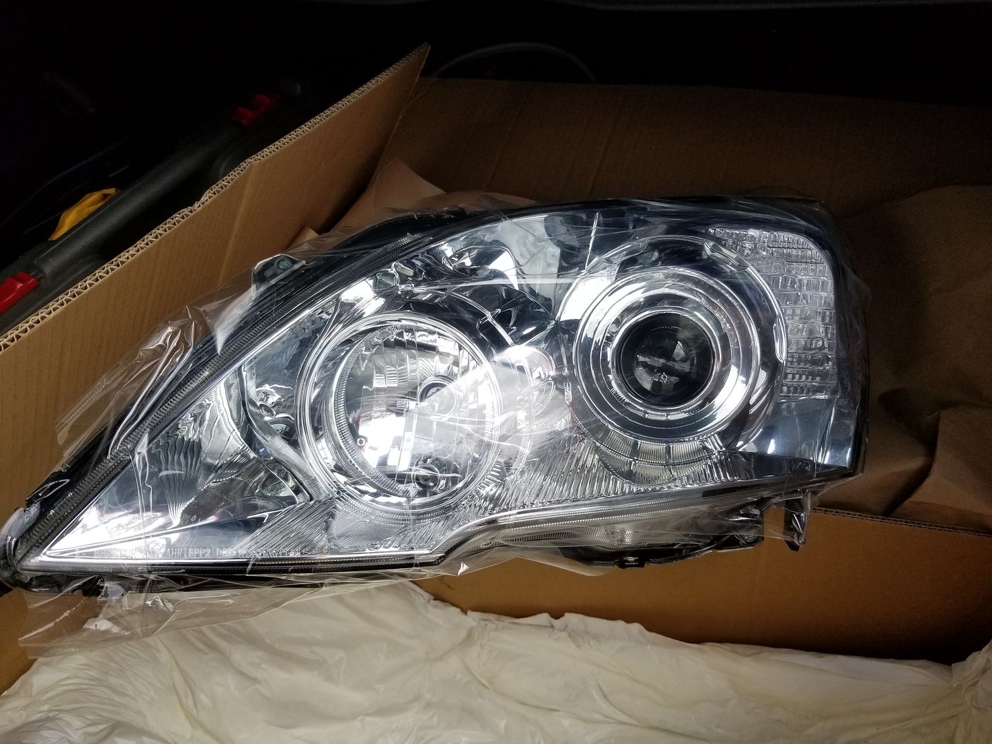

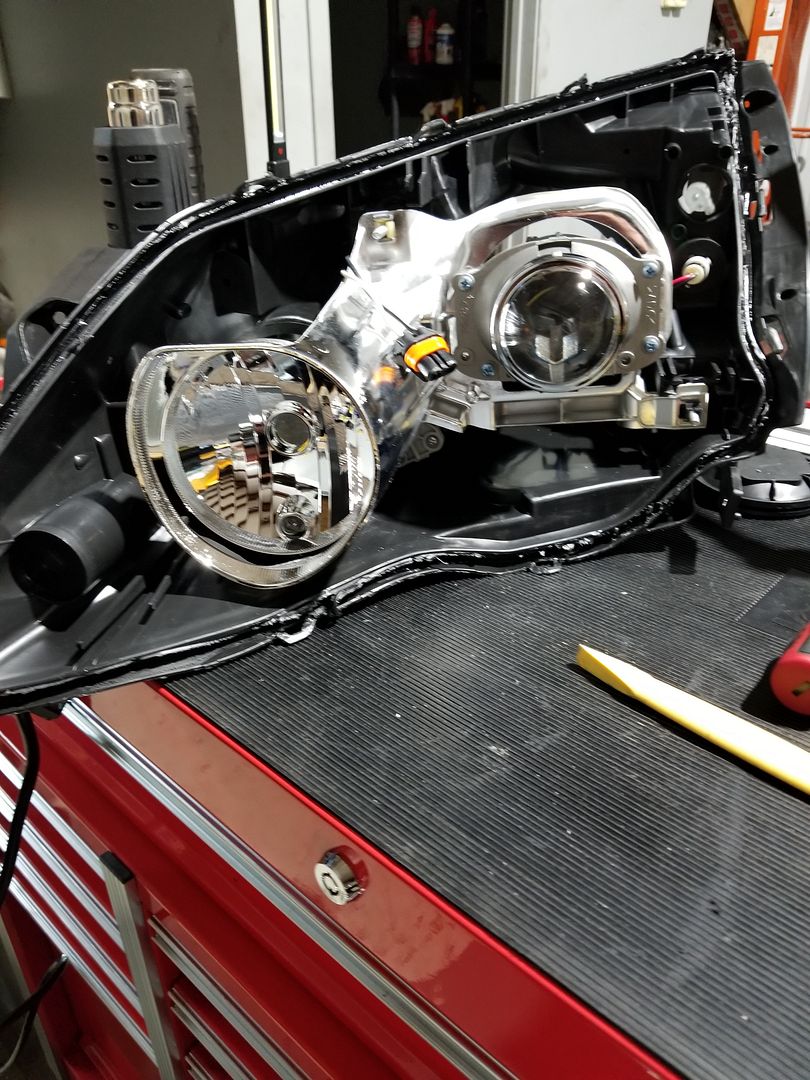

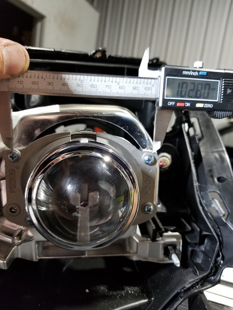

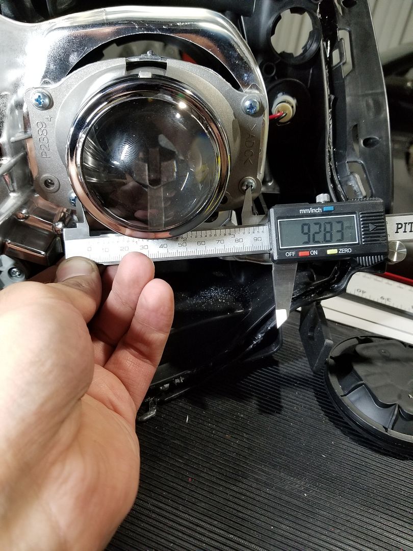

    I recently purchased some projector headlights from ebay for my 2007 Honda CRV. They're EUDM replicas. I got around to taking one of them apart tonight to see what I could fit in there for a proper bixenon projector. I've read that the 4TLR projectors are a drop in for most Hondas but after looking at the measurements on Morimotos website it doesn't look like it will bolt in. I don't mind mounting projectors with epoxy but I'm concerned that I might have clearance issues being that the projector shroud is part of the housing. Another thing I wanted to do was paint the housings like some of the Euro headlights. It's like a smoke chrome. I tested out some paints on some spare junk headlights I had laying around and couldn't get the results I was hoping for. I tried VHT nite shades and Duplicolor smoke metalcast.

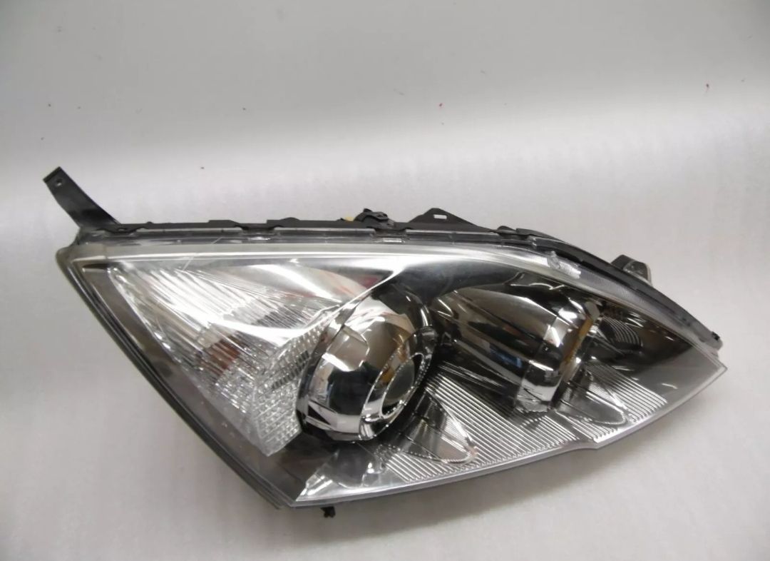

    Pic of dark housing Euro headlight
    Those look like TSX low beam projectors, but with an H1 bulb instead of D2S. Odd.

      I ended up ordering the 4TLR projectors. Hoping they work without too much trouble.
        I'm not familiar with the TSX projectors but these headlights are just some cheap ebay reps of the headlights that Europe and Asia got. Still gotta figure out the parking and turn signal lights. Not much effort from the manufacturer when they made these.
