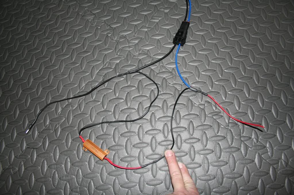

    Here is a picture of the LED sequential harness showing the load resistor location.

    Installing them on my customers truck we noticed that they were not working correctly, the first 3 leds would come on bright but the last 2 were very dim.
    So I cut out the load resistor and strangely it started to work.
