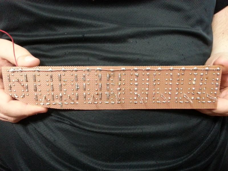

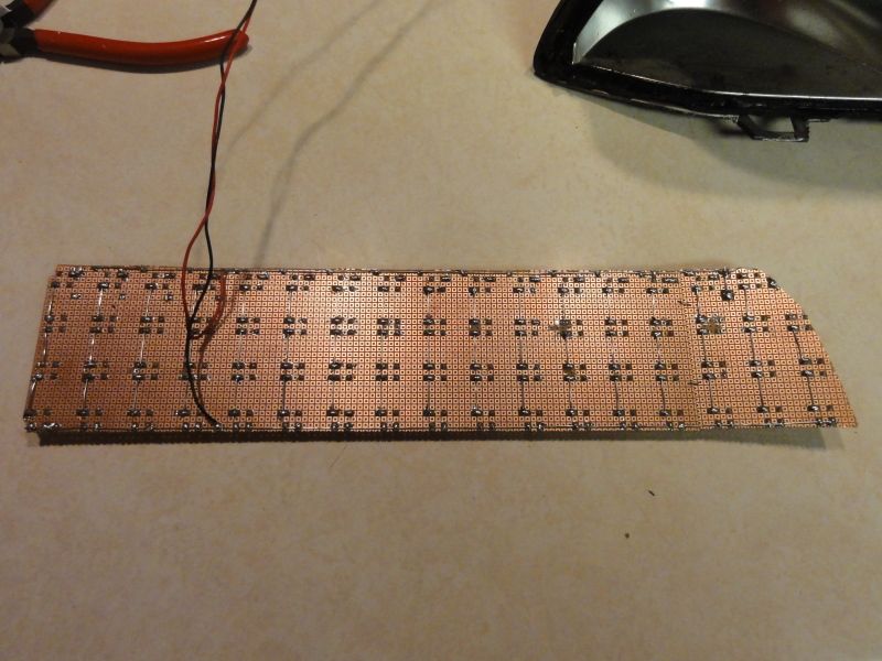

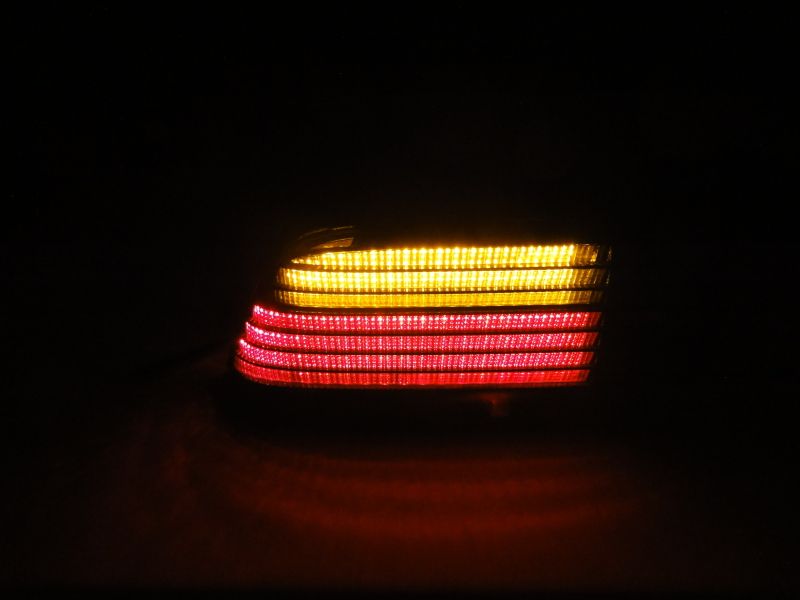

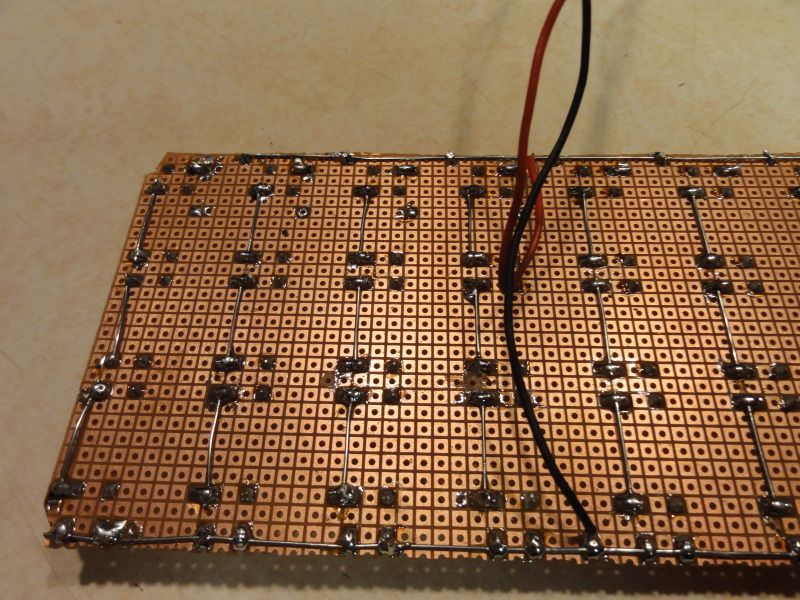

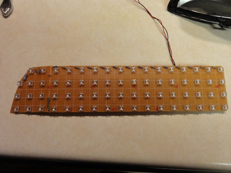

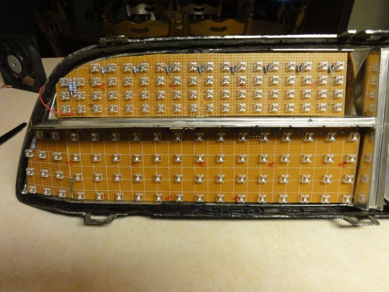

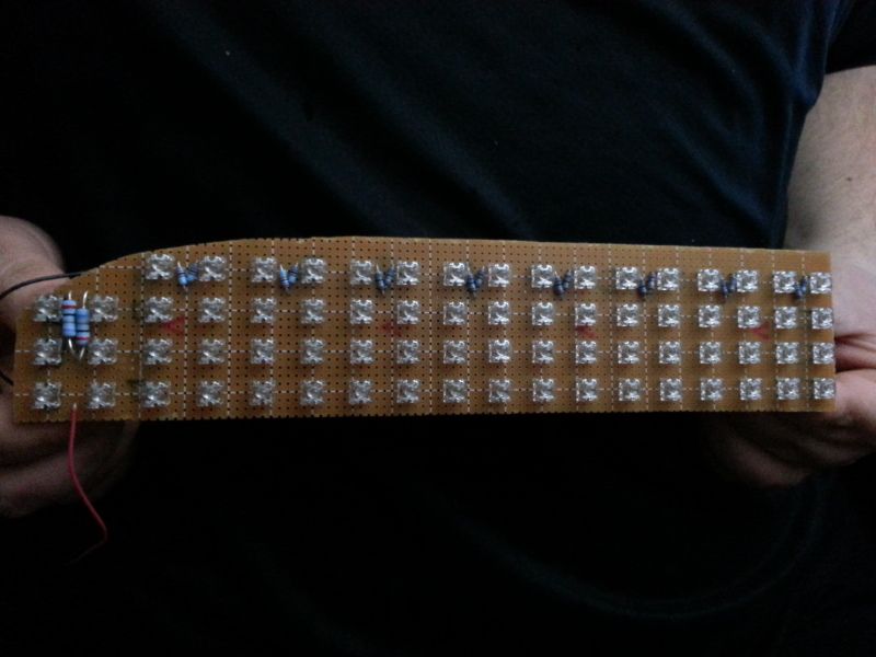

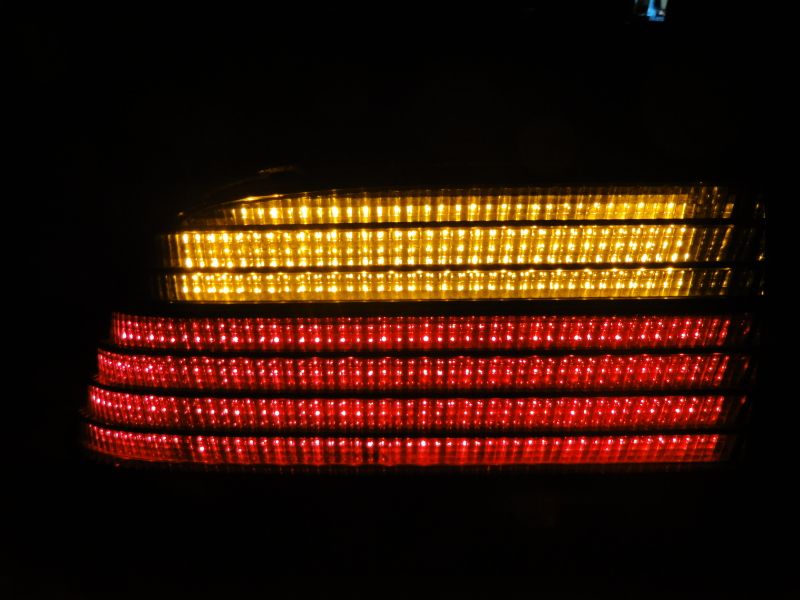

    Here's the retro fit I am doing for my dad's Fiero's tail lights, it is my first complete retro as I've done a few side markers and third brake lights but never anything this size. It is all mocked up right now, I just need to figure out how to seal the boards circuitry and mount them in the housings. The turn signals chase.

        The soldering job looks so clean. I'm about to post mine and the joints look like hell compared to this

            Thanks guys it was surprisingly fun to do these if you look past the few burns I got.

              I think the sequential signal looks weird or is it just the camera. It hesitates at points and has a weird flash/strobing thing going on. Seems as if it stays solid too long at the end of the cycle too. Otherwise, good job!
                I think it's the camera because it looks fine to the eye. As for the cycle I didn't have a spare flasher unit so I'm just manually switching the circuit on and off.
                  Looks great man!
                    Looks great! I like how the LEDs appear behind that lens, very clean. And the sequential signal is icing on the cake!
                      Likely the camera, my point and shoot doesn't like recording PWM'd LEDs at all. Lots of blinking and funny business on the go but to the naked eye, it's fine.
