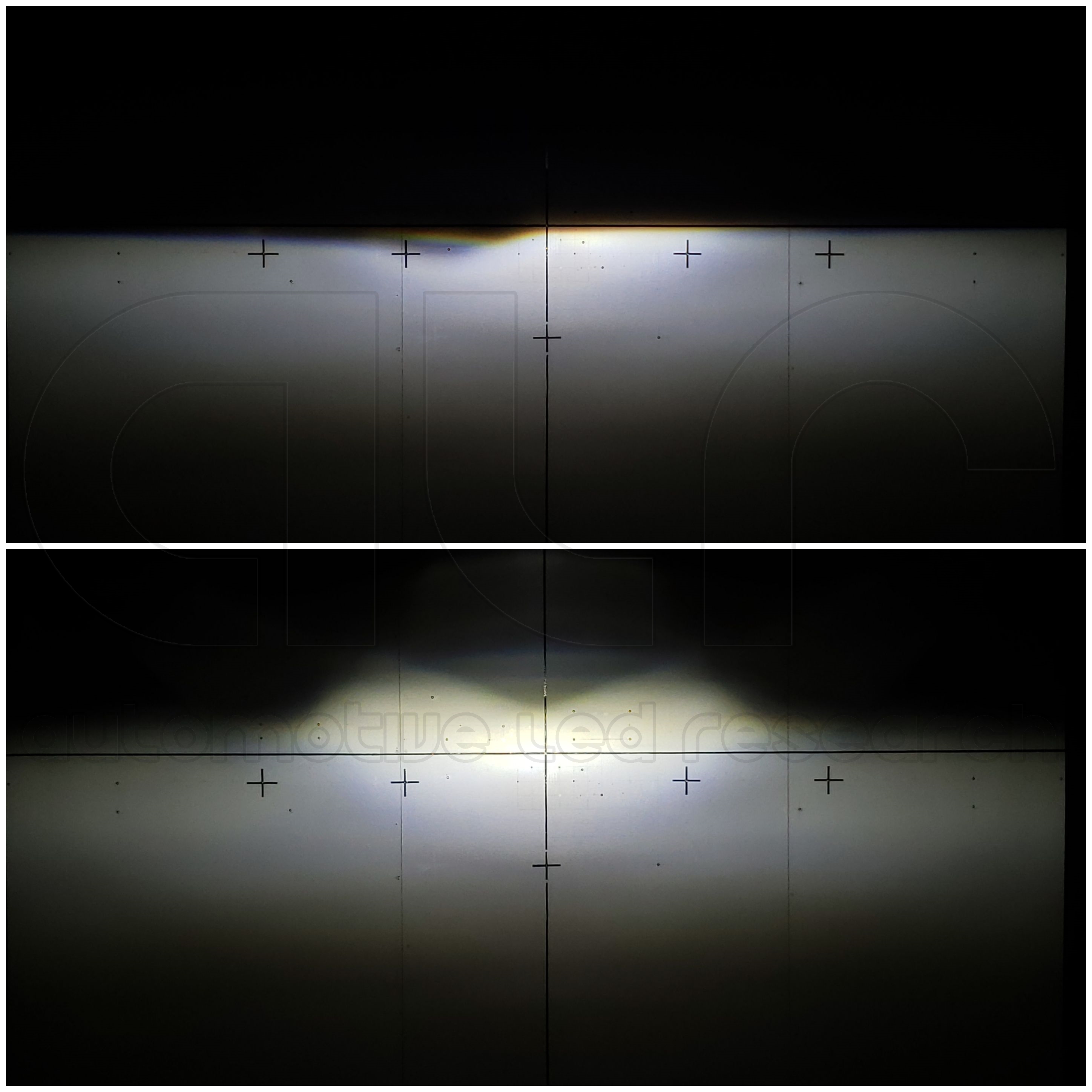

    Does the pattern look ok? Both projectors have the exact same pattern. It seems like there's some light above the cut-off:
    Here's the only sample I could find online, which seems to have less camera exposure:
    i think this is illumination for road signs

      That looks accurate and normal for OE projectors. It is required to have illumination above the cutoff line.

          Thanks guys! It's all clear now!
            They look like really good OE projectors. Forgive my ignorance to what vehicle they come equipped on. What vehicle are these specific Bi-LED Projectors from?
              I have no clue really. Some Toyota and Mazda models maybe?
