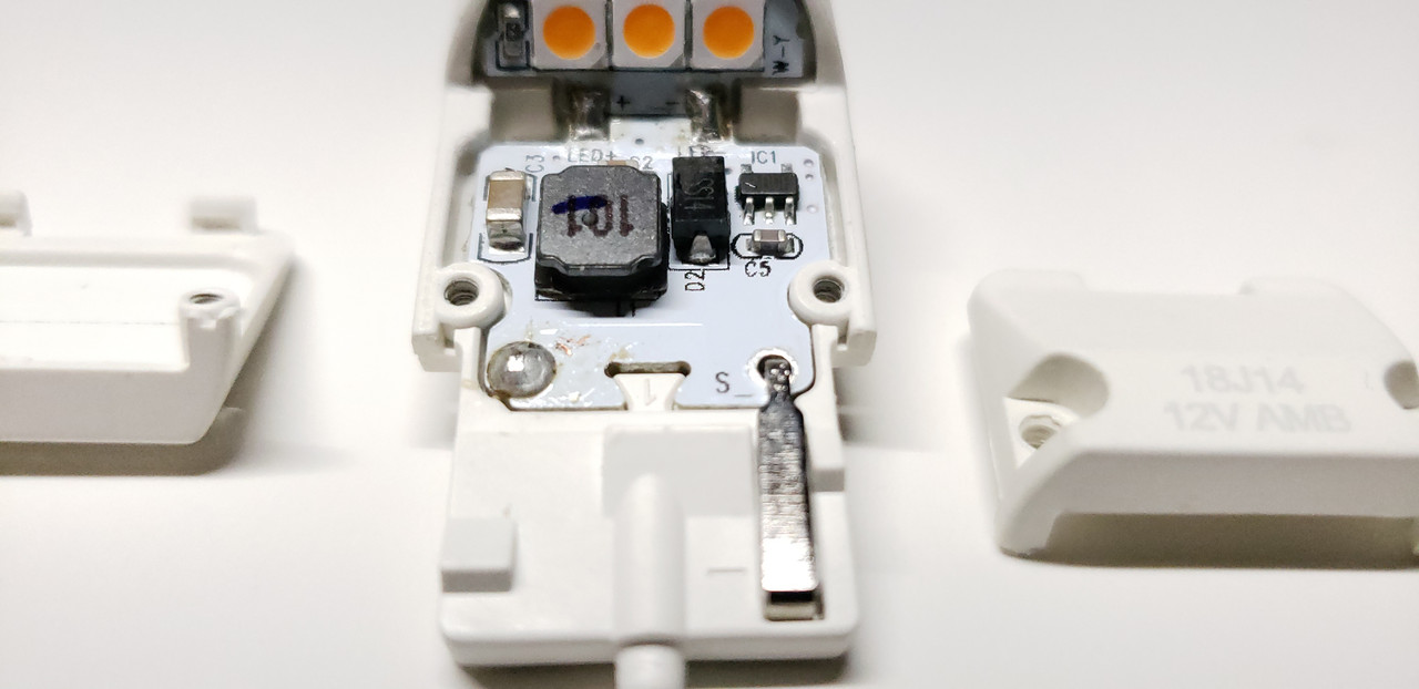

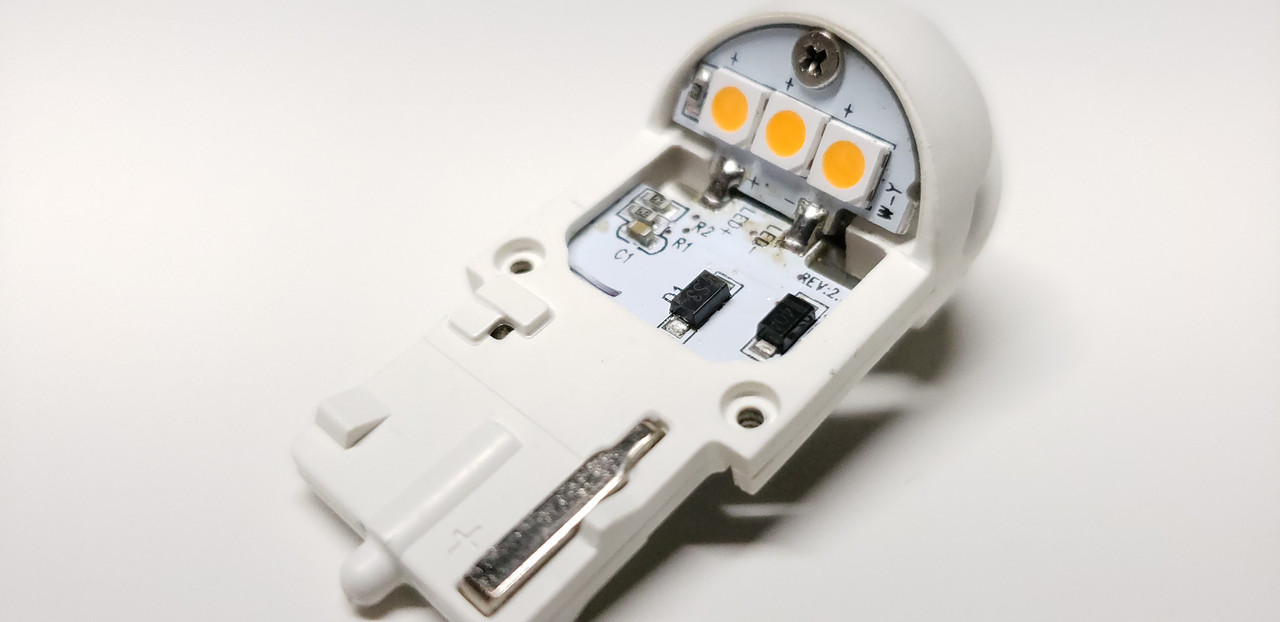

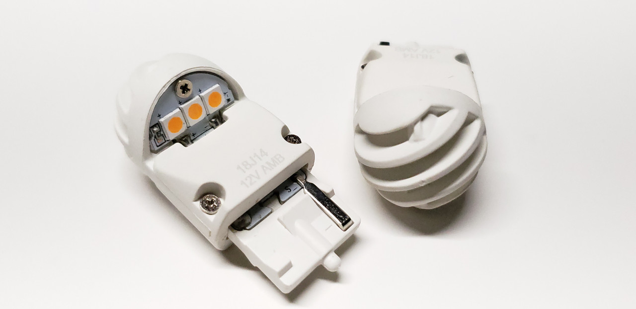

    Iíve got the 7440 amber turn signal bulb. Rated specs are 180 lumens @ 1.8w. The chips being used are the Lumileds Luxeon 3535L Color Line in PC Amber. A quick look at the datasheet says that at 100mA it produces an average of 29.5 lumens. So if we multiply by 6 chips than we get to roughly 180 lumens which is the rated flux. On my bench power supply these bulbs were drawing 0.13a @ 13.7v. It matches up to the specs.

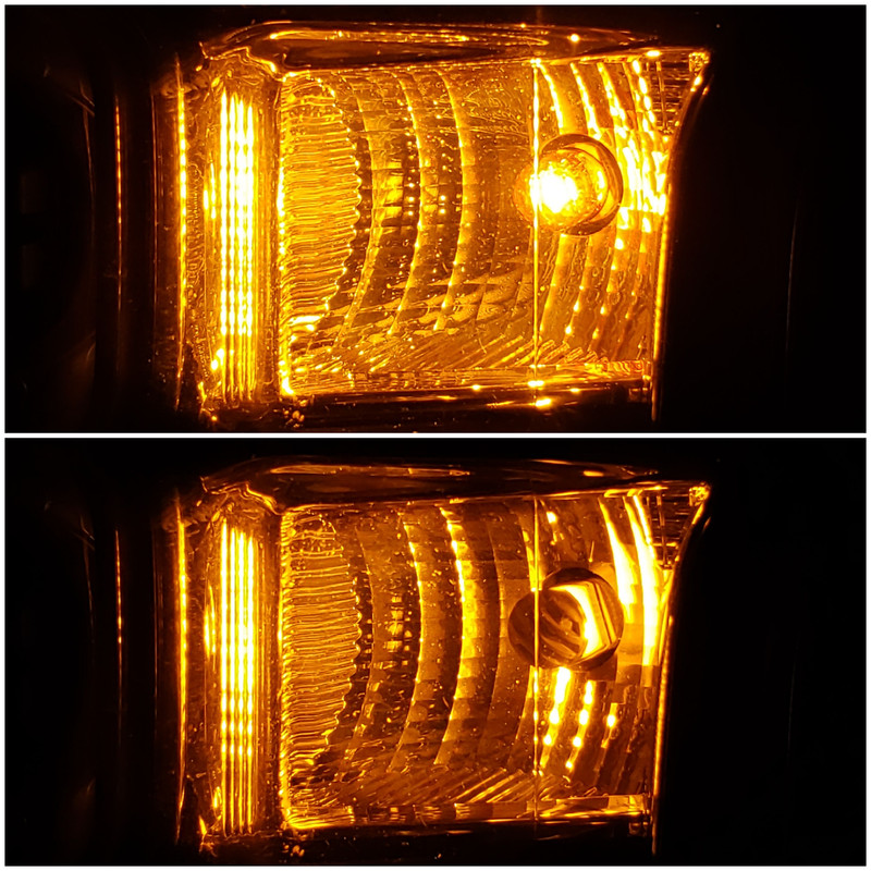

    I donít have any tail lamps for testing but I have plenty of headlamps. And while the 7440 (single filament) application is specifically for the rear, I decided to test them in a 7443 socket (dual filament). Optical properties are the same though since both bulbs use the same specs for its major filament. Some light shaving with a mini file to remove the fitment tabs on the X bulb allowed them to slide into the headlamp socket. First test lamp was a 15-18 Ford F150. I also tried them in a 17-18 Nissan Rogue headlamp *but did not take photos*.

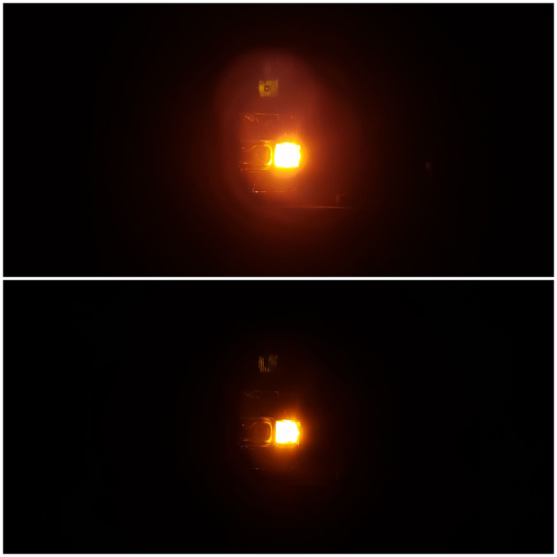

    I had a chance to do a little more testing. The aforementioned Nissan Rogue headlamp (with images now) and a Honda Accord headlamp.

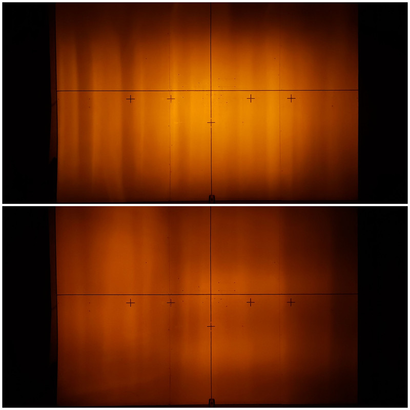

    The test results were taken at 10 feet from the measuring screen. I took 3 readings at the lower plus marking on the wall and then 4 degrees left and 4 degrees right. There is a photometric test point grid specifically for turn signals in the FMVSS 108 standard but I donít have those points setup on my wall yet so I decided to use these points which are sort of center in the incandescent beam, just to get an idea of what kind of illuminance is being projected.
    Measurements are listed as LEFT/CENTER/RIGHT and in lux units.
    Ford F150 headlamp
    Incandescent
    89/89/92 lux = avg. 90
    Philips X-LED
    31/44/36 lux = avg. 37
    NET GAIN/LOSS = -58.8%
    Incandescent
    45/72/42 lux = avg. 53
    Philips X-LED
    19/26/20 lux = avg. 27.6
    NET GAIN/LOSS = -59.2%
    Incandescent
    54/95/70 lux = avg. 73
    Philips X-LED
    34/29/27 lux = avg. 30
    NET GAIN/LOSS = -58.9%
