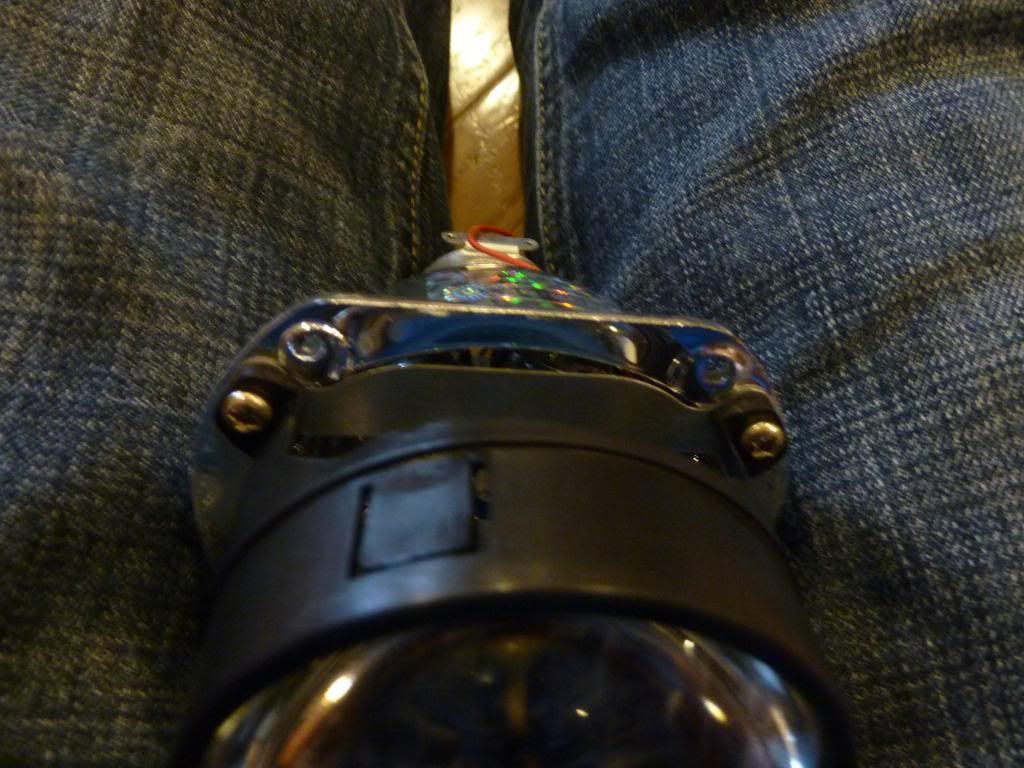

    At the top of the shield there is a narrow slit which allows the light to shine down on the road. It's not much light but enough to be annoying in some situations. It can be easily fixed by aluminum tape. But why would TRS not redesign the shield with the bowl?
    Slit at top
    Didn't show up too well, but i think it is visible.
    Heat can escape.
