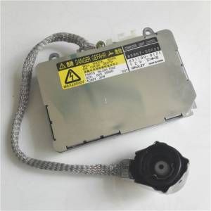

    OEM Denso

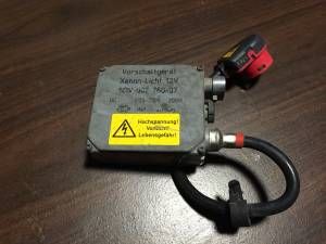

    OEM Hella Gen 3

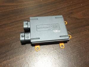

    MORIMTO XB35 V1

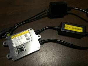

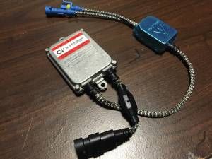

    ALPHA

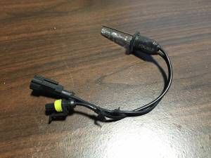

    HYLUX

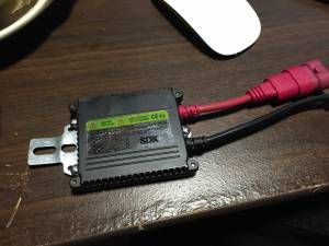

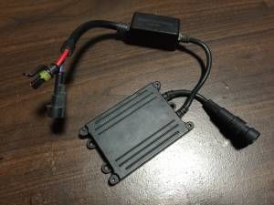

    GENERIC EBAY

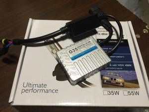

    BASIC $30 AMAZON KIT

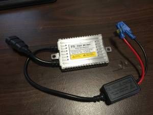

    DLT F5 FAST BRIGHT

    Hella Gen 3 35W = 949 lux
    DENSO 35W = 913 lux

    Morimoto XB35 V1 35W = 999 lux
    Alpha 35W = 998
    Hylux 35W = 922 lux
    Generic eBay 35W = 910 lux
    Basic $30 Amazon Kit 35W = 675 lux

    DLT F5 Fast Bright(1) 55W = 1200 lux
    DLT F5 Fast Bright(2) 55W - 1216 lux Approximately same warm up time

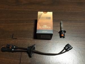

    H1 Morimoto XB 6500K

    H1 Morimoto XB 6500K = 1298 lux
